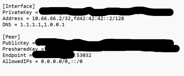

My VPS server settings are:

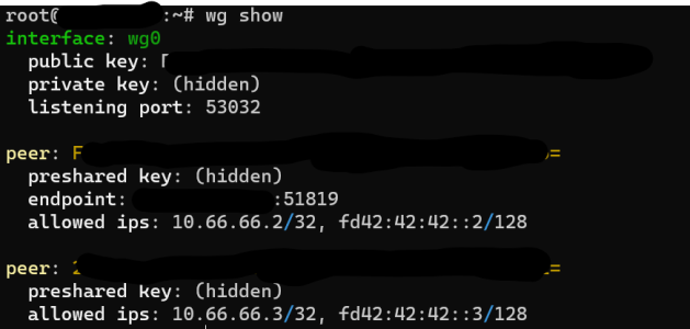

I did everything as you wrote. How to check that everything is working? The
wg show
command on VPS produces the following result
wg show
Looking good!
There is one more thing. You need to tell wgc1 on your router to listen to your port. I'm hoping it would be as simple as:
wg set wgc1 listen-port 51819
If you execute this at the prompt it should just start to work. And if it works we need to make this command autostart.
You should be able to confirm the listen port by
wg show
on your router.
