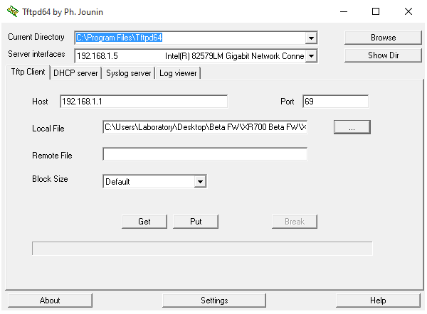

I was able to reflash the router using Windows TFTP to 192.168.1.1 on latest stock firmware, then updated to your latest firmware. All seems good now. Was scared, thought I bricked it somehow.
How did you do that? I have the same problem. I cant connect to 192.168.1.1, reset doesnt help.

I'm not sure what I'm doing wrong, but I had my rbr50 go down after an hour on the custom firmware and won't start back up. When I follow these instructions, I get "Connect request failed" and a red blinking power led on the back of the orbi... these directions don't seem to be specific to the orbi, is there something different that I need to be doing?
I'm not sure, but I will suggest to look specifically at item #22 in the support article - which is holding down the reset while powering back on. There is another NG article floating around on the web that is almost the same except that it omits holding down the reset while powering on, which is what was screwing me up for the longest time. I followed the article to the letter and it worked so not sure what else it could be.
Yes ussually they will not connecttion.
Tricky is those step below
  1. Turn router OFF for 10 seconds.
  2. Hold down the reset button on the back of router with a paper clip.
  3. Power ON the router while holding down the reset button.
  4. Watch the Power LED. It starts with an orange color, and then start flashing.
  5. Count at least 10 flashing power LED and release the reset button.
  6. Press Enter to execute the TFTP command. Wait for a few minutes (be patient, do not reboot the router). When the upload is successful, the Power LED will turn solid. The rest of LED’s on the router will also turn ON indicating that the router has booted up properly.
If it not work you can do another way:
Power on RBR50 waiting to led ring blink white.
Hold the reset button until power led blink orange or red something and use Tftpd64 to flash stock firmware
https://kb.netgear.com/000059633/How-to-upload-firmware-to-a-NETGEAR-router-using-TFTP-client
