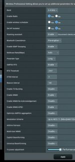

My settings are:
<snip>
I've left most at defaults, and only changed a few settings based on recommendations. Have I missed any significant ones?
Quite a few professional settings enabled on the 2.4 GHz band that don't have a good effect on wireless performance in my experience. These are the only professional settings I have enabled on both the 2.4 and 5 GHz bands on my AC86U:
  • AMPDU RTS
  • Enable WMM
  • Enable WMM APSD
  • Modulation Scheme set to MCS 7 (802.11n) on 2.4 GHz and MCS 9 (802.11ac) on 5 GHz (I've experimented with the higher non-standard options and saw various issues with different devices)
With these settings, devices consistently achieve the max speeds they're capable of on each band and on the 5 GHz network they max out our 200 Mbps down / 20 up service.

You haven't commented on the wireless settings I've got. As far as I am aware, these are in accordance with the mythical best practice settings. So do I take it that I've not done anything obviously stupid with this, so I need to leave the router alone and be looking at something elsewhere?
  • AMPDU RTS
  • Enable WMM
  • Enable WMM APSD
Thank you! That's the kind of list I was hoping to see - what features users have found that work for them, or what combinations jsut don't work.
I've just adjusted the settings to match your suggestion. Still doesn't seem to have had a positive effect yet, but I'll let it settle for a while to see if it picks up a bit overnight.
Any comments on other parameters like the RTS Threshold or Preamble length?
