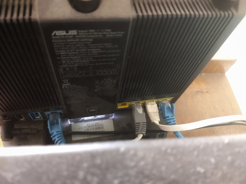

Similar setup. I'm using an AC68P with 384.14 b2 and an older DiskStation DS212j with DSM 6.2.2-24922 Update 4
The AC68P only have an internal 4 ports, Broadcom switch. I'm using pot 4, but tested port 1 and it works just fine.
Originally I was using the white cable of the first picture to connect the NAS. With that cable I could only get 100 Mbps.
Then I changed the cable for a new 3 feet cat 6 cable and managed to get 1 Gbps.
