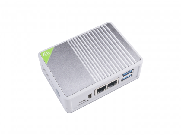

I've been a big fan of quotom boxes for routers (pick your software) as well as RPi 4b for a gps/ntp - or just about anything you can throw at them. The new compute module RPis are the way to go if you can buy/find one (eventually) as the host cards for them are evolving quickly...
Hadn't heard of this series before....very interesting.....
yes, as the new compute module is a daughter board that will drop into host pcb boards designed for differing hardware applications... as well the new compute module can be ordered without wi-fi - possibly practical when external APs are added in a router/AP application...
