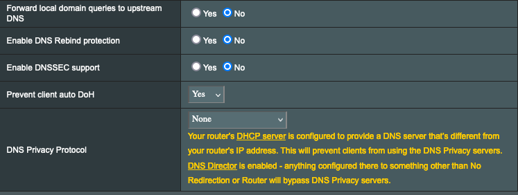

OK thanks. I still have WAN DNS set to Quad9/ISP and LAN DNS set to the IP of my Rpi.
Will changing any of these settings interfere with the Rpi/AGH, and is there any benefit in setting them to on?
They are of no benefit to you unless you have clients who query the "router" himself for DNS, those options are for DNS-Hardening of the routers "built-in" dns services (a.k.a. Dnsmasq). If you are not using DNSMASQ directly for DNS services, those options are just eating up extra resources. DNS Rebind might even break any conditional forwarding statements you have in AGH used to determine client namespace from the routers DNSMASQ instance. Since your clients have the AGH address handed out over DHCP, they are querying AdGuardHome directly. So, you only need to make sure all your DNS-Hardening is done in the AGH Webui. Any "extra's" you do with the router and DNSMASQ at this moment in time would be a waste of resources, and possibly breaking to your clients local namespace resolution.

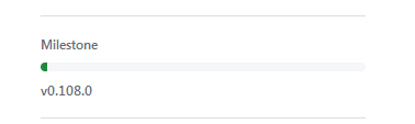

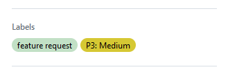

People should keep an eye on this feature request:
Once it has been finalized and submitted, I would be happy to research other possibilities for DNS configuration with AGH with users here on this forum. Until that time, the only way that make sense is to hand out the AGH address with LAN DHCP options, and DNS hardening done only on the AGH Webui.
