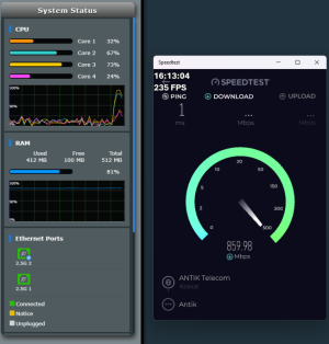

Just to chime in: AiProtection disables NAT Acceleration. This lowered my gigabit connection by around 100-150 Mbps, but mosty importantly it increases router's CPU usage. A lot. Doing a speed test maxes out two cores.

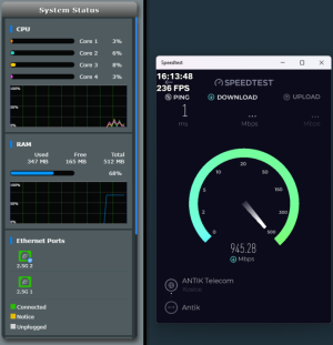

I don't think this is true but someone correct me if I'm wrong. I have AiProtection enabled and always have:
HW acceleration    Runner: Enabled  -  Flow Cache: Enabled
With vs without. Check the speed and hardware use.
To clarify, I'm not saying it doesn't affect speed. I'm saying it doesn't disable NAT Acceleration.
It does on mine. And it should, because it does IP inspection and type of IP inspection disables NAT Acceleration.

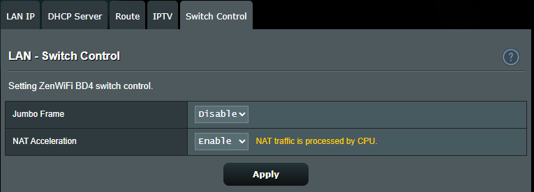

To clarify, it is enabled on my system as well, but it doesn't work:
On the System Info tab it has a line that shows whether it's enabled or disabled. I'm curious whether it says enabled or disabled.
Our posts crossed, got it.
I have 1400Mb connection and on my AX88U Pro it goes full speed with AiProtection on. The system does a light inspection. The results depend on the processor speed. What model are you using?
I believe the OP is using stock firmware (as per this sub-forum) so he won't have that tab. He's also using a ZenWiFi BD4 which makes it uncommon hardware.
