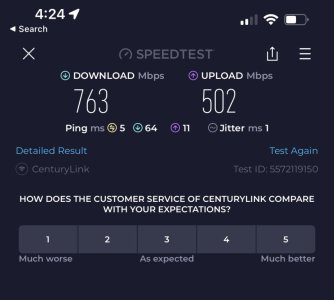

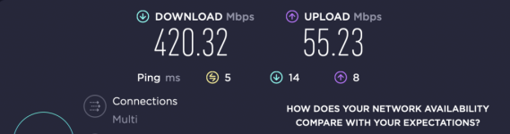

I would like to add in on those asking for ET12 Merlin. I came from RT ax88u and i swear the century link fiber was faster on that rig with Merlin’s.
1 gig network
Sample WiFi test:
