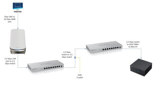

The Orbi I purchased is their top-of-the-line mesh networking system, and the router has a 10 Gbps WAN port and a 2.5 Gbps LAN port, as do the three satellites. The attached illustration shows my network flow.

A top of the line Asus can't do 2.5G if you enable various features, so I wouldn't consider "top of the line" a valid test of what it is actually capable of. Have you tried any of the other suggested tests?
