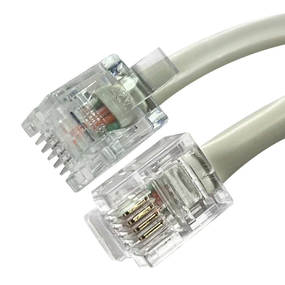

After a bit of advice on a new cable, How is this for a replacement DSL cable.
DSL Cable
after a twisted shielded cable?
Unbranded cable from ebay - Should be OK but probably overkill if it really is what it says it is. But there's really no advantage to using shielded 8 core Ethernet cable for DSL as only two of the wires are used and there's no earth connection for the shield at either end. Still, it makes it sound good in the advert. That said, the shielding might help a tiny bit if you're laying a long length of it right alongside a mains power cable. The disadvantage of using Ethernet cable for DSL is that it's unnecessarily heavy and inflexible compared to a standard telephone cable (which may or may not be a concern).
Any decent quality RJ11 telephone cable should be more than good enough. Bearing in mind that the majority noise/interference issues will be with the 2+ kilometres of cable running between your house and the exchange. An extra 5 feet at your end won't make that much difference.
thank you for your input, and well was thinking shielded as cable is 5 meters and it go's from hallway, around the door frame, then throw wall and about 1ft is the router. and what your saying about cable yes its only 2 core normally twisted so its 4 wires.... from that am thinking
2nd cable?
tyes its only 2 core normally twisted so its 4 wires....
That's not what "twisted" means. It means each pair of wires is twisted. So a standard 8 core Ethernet cable has 4 pairs of wires and each pair is twisted. So for a DSL connection you would be using one pair (two wires twisted) and the remaining twisted pairs are redundant.
thanks you, cable sorted now i end up getting 1 from my online pc hardware shop, will see how it go's.
