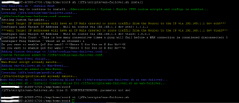

Hello @Ranger802004,
Did you know if your script work with @eibgrad's killswitch script ?
Because I tested yesterday on my RT-AC88U (386.7_2). Failover Wan and Lan1.
But the WAN was already disconnected.
I'm not familiar with what the script does but what issue are you having exactly?
