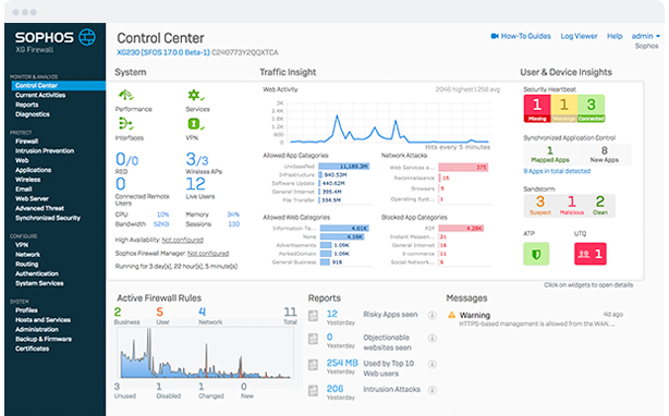

I need one multi-NIC mini-PC like this for my Sophos Firewall exploration. I had it running few years back, but now there is a new XG based Home Edition. Unfortunately, it needs 2x NICs minimum. Can't be installed with VLAN LAN/WAN on single interface like pfSense.
It looks interesting and not too complicated for home use:
An idea for @GHammer. Free software for home use. If it can be run on this $150 box - bingo!
