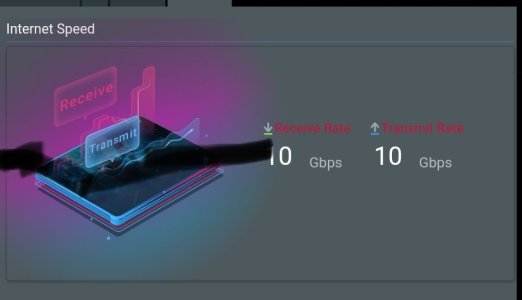

OMG look I connected the router straight to the ont box WOW now I'm gonna look on Amazon for an Ethernet cable that can reaches where I normally have the router
That's link speed, not Internet speed. Still, go get the longer Ethernet cable; it would be an improvement, I think.
