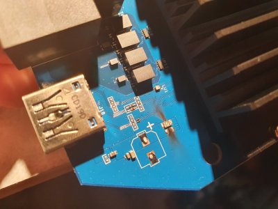

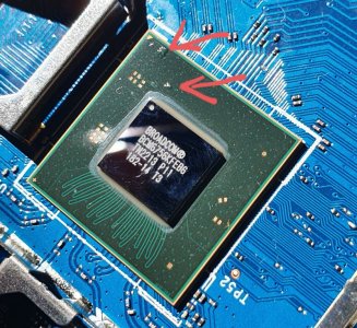

Some people will try to reach the borders with a goal and common sense... Others are just... For example, i have a warranty return AXE7800 board where the user tried to power the board via the USB 3.0 port...
