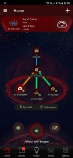

I don't know how many of yous having issues with AXE1600 Aimesh setups, but it's very annoying and not with with latest firmware. I got two AX11000 as nodes and AXE1600 as main router. The connection always drops and goes back to 2.4Ghz backhaul with weak signals. Even thought they are all within 5 meters from each other. Decided to use AX11000 as main router and no issues at all but AX16000 still 2.4Ghz backhaul and weak signal. Seems like it is not Aimesh friendly at all. I bought it from overseas cost me $16000 and can't even return it. Stock with this heavy boat anchor.
Three APs 15' apart is madness... have you no confidence in radio!
OE
@HadiNZ, waaaaaay too much WiFi!
I have had zero issues with my AIMesh config. 16000 main router, three AX86U nodes, wireless backhaul. I’m covering a lot of distance and walls between units. Approx 100’ on different levels.
