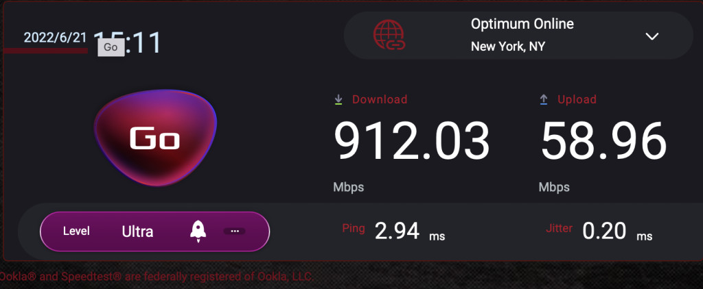

This test is straight from the router, and when connected to ethernet from a PC or Mac or other gaming/media devices , the upload is 20~30 Mbps. I restored to factory but issue persists. I connected my old router (GT-AXE11000) I would get 850Mbps upload. So definitely a router/firmware issue
This test is straight from the router, and when connected to ethernet from a PC or Mac or other gaming/media devices , the upload is 20~30 Mbps. I restored to factory but issue persists. I connected my old router (GT-AXE11000) I would get 850Mbps upload. So definitely a router/firmware issueView attachment 42027
