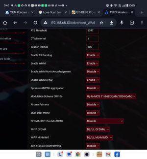

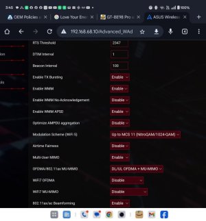

There is no WiFi 7 toggle on the more/most recent firmware. On the Professional tab selecting 6 GHz you should be able to scroll down towards the bottom. They have now four relevant settings:
OFDMA 802.11ax MU-MIMO
WiFi 7 OFDMA
WiFi 7 MU-MIMO
802.11ax/ac Beamforming
I have a single 6E MacBook Pro and a single WiFi 7 phone, 6-1 and 6-2 set up one for each attached
