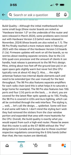

Does anyone have version 3.0?
The text with unknown origin you have posted contains incorrect information.
