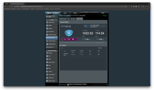

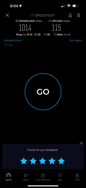

Hey guys, coming back here to post a quick update. Seems like I was correct in diagnosing router issues as part of things. After gettin the new router yesterday (Asus RT-BE92U) which has the 1x 10G port and the 4x 2.5G ports. It looks like the actual Cox issues are resolved for the most part and the remaining glitches are related to mixing old and. new hardware. While my Ethernet speeds can dip below 900 Mbps the wireless speeds on the phone are 900 to a little over a1G on a pretty consistent basis. However, putting speedtest aside, and looking at this purely from a daily use prospective, things seem to be stable now. I am glad I have full access to what I'm paying for now, even if not all my current devices can fully use it. Just means when I get new hardware, with updated specs. They'll be able to use the full connection.
Edited to add screenshots of wired and wireless speeds now.
