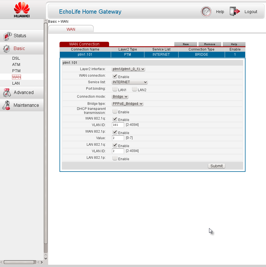

Can the AC68U be configured to bridge its WAN port to LAN while also connecting to the PPPoE service over a VLAN on that same WAN port?
If so, you can actually configure the HG612 to transmit both WAN and LAN traffic over the same ethernet port and thus just the single cable. Although I am using OpenWRT on my router to allow this configuration, I'm not sure any of the commercial firmwares allow such fancy configurations.

Like I said, the HG612 CAN be reconfigured to send both WAN and LAN out of any of the LAN ports, if you have access to the Web UI. But your router needs to also support using its WAN port both to bridge to the LAN and to pickup the actual WAN connection on the VLAN.
