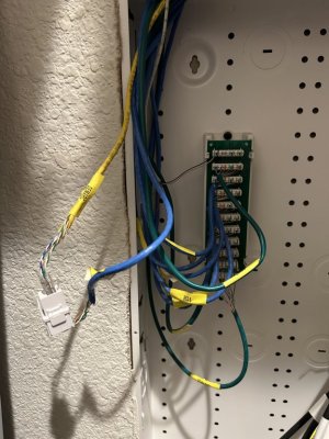

I just ordered it, should arrive tomorrow. I'll put the incoming yellow DEMARC plug into the switch, but apparently, I need to get from the switch to the junction box mounted at the back of the network closet.
How do I do that? See attached photo.

And now you have 2 problems to solve:
- the tech is correct - relocating the gateway in the closet will further reduce your Wi-Fi coverage
- you need to make cables with RG45 connectors for your switch - knowledge plus tools needed
You are facing more expenses (additional APs, otherwise mobile devices will suffer) and the switch you have purchased (no PoE, needed for the APs) is perhaps wrong choice. The tech who installed the gateway connected the ONT cable to the location of the gateway. There is a single Ethernet cable to this location and you have to move the gateway to the closet where the switch is going to be. The gateway will have not only obstructed Wi-Fi, but may also overheat in a confined space with no sufficient air flow. Why don't you give this project to someone who know what are they doing?

I agree, this is over my head.
I just purchased a crimping tool and some ethernet plugs that arrive with the switch tomorrow from Amazon. But I may have to send them back and hire someone. I'm in Reno, NV, trying to find someone who can do home networking.
Correct, and the gateway is "centrally located" but due to the stucco construction and the layout of the house, the WIFI would have to pass through two outside walls. As you may already know, stucco is attached to a chicken wire, which can't be good for WIFI reception.
The house is wired with CAT5 ethernet cable and there is a jack in every room, for every computer and TV.
I don't want to beat this to death, but how the heck do you get AT&T fiber into the home ethernet system? Does the AT&T gateway have to go before EVERYTHING?
Thanks again, I appreciate it.
You have an ONT somewhere, perhaps in the basement. This is where the yellow wire is coming from. The gateway is a AIO router with Wi-Fi. The tech connected the ONT wire to the blue wire going to this "central location" and he did the right thing. This is what can be done for free with the ISP equipment provided. The tech did best effort to make it better for you. From this point you have to decide what do you want. Improvement won't be for free and the switch you have purchased solves one problem, but creates another.
If you find a proper tech to do it for you - I personally would go for Ubiquiti U6 In-Wall APs. They have built-in switch for local wired devices. A few around the house with Cloud Gateway Ultra in the closet with Lite 8 PoE switch. A fan in the closet to move some air, eventually. Complete Ubiquiti UniFi system, total cost around $600*, set and forget. Can be done with Omada hardware for less. Wi-Fi around the house and Ethernet ports as you wish. If you are paying rent for this ISP gateway - not needed anymore, can save some bucks monthly.
* - the installation cost on top, obviously.
You can go cheap with the APs, some consumer Deco for example. It depends on the budget and requirements. I have installed 2x Deco M4 sets for $100 (2-pack) in houses where owners have no idea about tech. M4 is Wi-Fi 5 "mesh" set, does 500Mbps over Wi-Fi when wired. Single SSID, no much settings, easy App control, no extra Ethernet ports, some hanging off the walls adapters, definitely not the latest and greatest, but... $100. People are happy.
