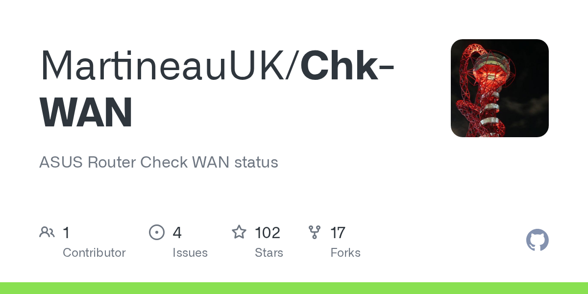

1) Someone has kindly done all the work in scripting / testing wan is up, if not then reboot your router. Read the instructions and get the files here:
Note: Do not copy and then paste the script into a new file from github to a windows operating system -that will not work as you created it on a windows OS, its so much easier to download the file on git, use that, do not open/edit in a windows OS, it may save to a format the router os might not like.
To be clear on how to download from github, if your not familiar with github, goto the url https://github.com/MartineauUK/Chk-WAN, click on the green 'Code' button, a drop down menu appears, at the bottom after clicking you see the option to download as a ZIP, download and extract to where you see fit, I used c:\temp\trans (I'll use this location for future examples below). You only need to extract 'chkWAN.sh' to c:\temp\trans.
