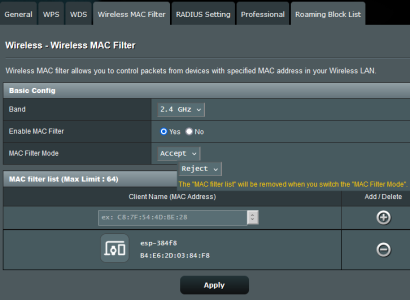

Wireless MAC Filter in Wireless settings page, look at the tabs on top. Select the band, enable it, select the device, Apply.
I found the place you pointed to but I still do not understand how to use it...
It is very terse as shown in the edited screenshot.
The action can be Accept or Reject. Can the router use both at the same time?
I guess not, right?
So it can be not active (default), reject or accept.
In the latter case it will need a long list of accepted devices I guess....
Last item: If I activate this will it affect ONLY the WiFi on the main router and NOT on the AP?
So when the MAC is allowed in via the AP it will be operational network-wise?

I tried the MAC reject filter on my router and it was accepted for the MAC address of my IoT device.
However after applying the change the device is still connected to the main router's WiFi and is still reconnecting every few minutes as seen by the MQTT log items it sends when connecting.
How can one push the device off the main router's WiFi?
