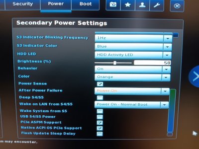

I have an older nuc. What do you have set in the BIOS for "After Power Failure" and the Deep/Wake S4/S5 options?

I assume you mean that on your NUC the system restarts by itself following a power outage?
Or did you mean that with these settings the WakeOnLan function is enabled and working?
Or both....
By just reading the screenshot I see the Power-On and Power-On-Normal_Boot items, which I don't remember having seen in my BIOS.
Question:
What does S4/S5 mean?
In my case I only have a time window between 09 and 11 each day in the morning (European central time) when I can test power handling by simulating outages and recovery functions. On the other time the server needs to be running and doing its work.

Yes, with those settings my nuc restarts after a power outage or WoL signal.
S4 and S5 are particular levels of sleep states.
Thank you!
I have now restarted the server and entered the BIOS settings where you indicated (it looks a little different but not much on my device).
After modifying the settings you suggested and done an F10 Save/Restart I waited for it to reach the final running state.
Then I pulled the power plug and reinserted it after a minute or so.
Lo-and-behold!
Now my NUC13 boots up and is operational again by itself!
:cool::D
So again: Thank you very much!
