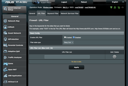

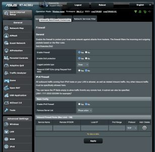

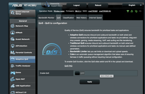

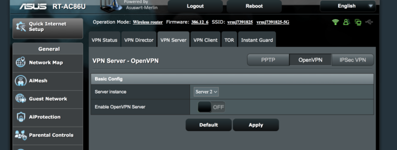

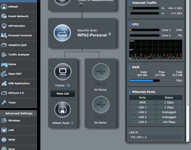

No changes were made, just the router is turned on and devices are connected. No manipulation was done with the firewall. All additional features are disabled.
