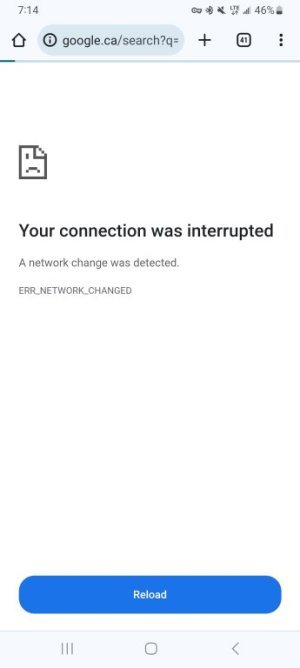

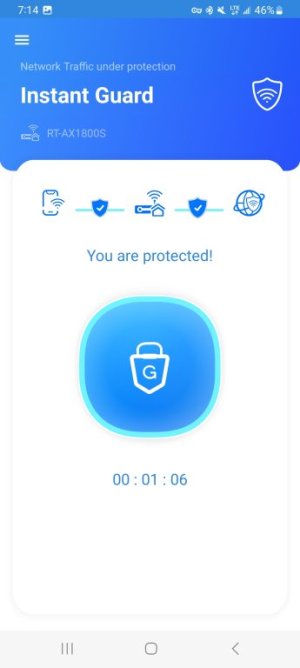

Hello, newbie here.
Just got an Asus AX1800S router and trying to setup Instant Guard. I have read all the forums and have used no-ip DDNS and Asus DDNS. Turned on remote connection and have turned on and off enable remote access on WAN.
Anyways my issue is I can get Instant Guard to connect but it doesn't have internet.
Using Instant Guard while on home wifi works but not when using mobile data.
Any ideas?
TiA.
