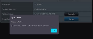

Hi, when I load the latest version of Merlin RT-AC88U_386.7_2, when I try to load it on my AC88U, it tells me "Signed Version" and does not load the firmware.
You're loading the wrong firmware. You have a DSL-AC88U, not a RT-AC88U. Merlin doesn't make firmware for the DSL-AC88U.

The DSL-AX88U does not even run Asuswrt, so supporting it in either Asuswrt-Merlin or Gnuton's fork is flat out impossible.
