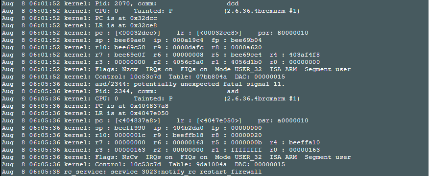

May 7 07:31:47 kernel: potentially unexpected fatal signal 11.
May 7 07:31:47 kernel: CPU: 2 PID: 1074 Comm: asd Tainted: P O 4.1.51 #2
May 7 07:31:47 kernel: Hardware name: Broadcom-v8A (DT)
May 7 07:31:47 kernel: task: ffffffc02ff90bc0 ti: ffffffc02ef44000 task.ti: ffffffc02ef44000
May 7 07:31:47 kernel: PC is at 0xf6d71a78
May 7 07:31:47 kernel: LR is at 0xf6d72cc8
May 7 07:31:47 kernel: pc : [<00000000f6d71a78>] lr : [<00000000f6d72cc8>] pstate: 200f0010
May 7 07:31:47 kernel: sp : 00000000ffa0f5b8
May 7 07:31:47 kernel: x12: 00000000f6d86154
May 7 07:31:47 kernel: x11: 00000000f6d755d4 x10: 00000000ffffffff
May 7 07:31:47 kernel: x9 : 00000000ffa0f5dc x8 : 00000000ffa0f5e0
May 7 07:31:47 kernel: x7 : 00000000f74a1ab8 x6 : 0000000000103b60
May 7 07:31:47 kernel: x5 : 00000000001039e0 x4 : 0000000000107890
May 7 07:31:47 kernel: x3 : 000000000000676f x2 : 00000000f6a00768
May 7 07:31:47 kernel: x1 : 0000000000000400 x0 : 0000000000000000
May 7 07:31:51 rc_service: service 9701:notify_rc restart_firewall

Your crash is related to the ASD Process which is different than the above whichs is related to the httpds process.
You can confirm if it's running or not with: ps | grep asd
More info about it from RMerlin here: https://www.snbforums.com/threads/what-is-asd-process.76242/post-729340
Were you impacted by the mass ASUS router ASD security outage a year or so ago?
According to @RMerlin some people running his firmware were also affected:
Might be worth factory resetting if you haven't since.
Here is one in sequence, DCD and ASD:
I was just playing with it, left it running, the result is above. 🤷‍♂️
