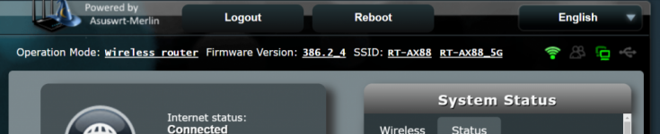

I have Asus RT AX 88 with merlin wrt (386_2_4 version).
I have a problem. I can't add users in my openvpn server. I write username, password, push add, apply, and the user don't apear in the list.
Somebody have some ideas?
That issue was fixed with 386.2_0 back in March. Double check which firmware version you are actually using.
This is my firmware version.
I turn off the router, i swhitched on/off openvpn server and still i can't add users.
