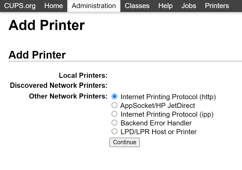

So I've hit another knowledge gap. Presented by the CUPS screen, I have no clue how to configure my Brother HL-L2300D for it. I know it's connected to the router and it's under the "lp0" in usb devices, other than that I don't know how to get its IP address or whatever to add it to CUPS.
Use socket://localhost:9100. Alternatively you could use the LPR protocol and specify LPRServer as the queue name. FYI device /dev/usb/lp0 has been created because you have (correctly) enabled the router's Network Printer Server option.
