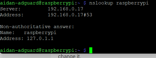

AdGuardHome is performing the DNS on a Raspberry Pi 4. Asus router is providing DHCP. I don't have Pi-hole installed.
Your DNS server seems to be set up to resolve names to local IP addresses but not vice versa. I don't know anything about AdGuardHome so I can't counsel on how to fix it to do both. In a standard DNS server like BIND, forward and reverse maps are totally independent and you have to put an entry into each one if you want both lookup directions to work. AdGuardHome might have scripting to make that easier, but if so it doesn't seem to be working for you.
Adding DHCP into the mix makes that even more fun, because then you don't have any solid fix on which IP address will be handed out to which machine. Some systems have built scripts that pull assignments out of the DHCP server and put them into the DNS server, but that's all ad-hoc hackery AFAIK, and there sure won't be any such cooperation between your RPI and your Asus router.
For me, the path of least resistance has always been to statically assign IP addresses to machines that I cared about having DNS entries for.
