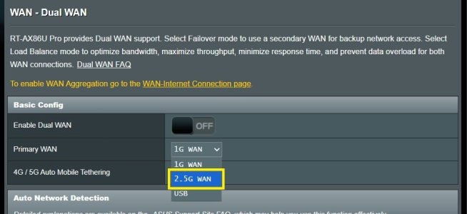

Dumb question time. When you changed the WAN from the 1GB WAN port to the 2.5GB LAN/WAN port, did you also change the Primary WAN setting in the router GUI > WAN > Dual WAN to match? Did you inadvertently enable Dual WAN?
Example from stock Asus firmware on a RT-AX86U Pro, should be the same/similar for Asus-Merlin firmware.
No. As per your screenshot I changed the primary WAN to 2.5G. The “enable dual WAN switch is still OFF. The router rebooted to apply the settings and I’m connected again and typing this message via the wifi connection.
