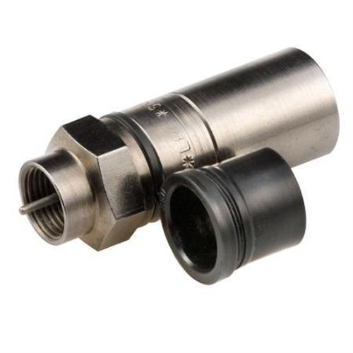

I have gone through the coax cabling as best I can to look for faults. I found one short run of RG59 which I replaced with RG6. I found a length of RG6 that had damage to the outer sleeve and replaced it. I have replaced the RG6 connection between the two splitters (about 40-50 feet apart) with RG11. I have replaced both splitters. And I have reterminated basically every cable end with new f-type connectors.
It hasn't made a bit of difference.
