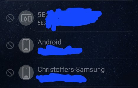

My main, guest and iot network have all different IP addresses so it looks good :) Thank you so much for your help! One last thing. I'm trying to delete these offline devices in the picture from the list, but when I restart the Asus APP they are back. I think they all are my phone... Are they some remain from when I connected my phone to my other networks to add devices? Can they be removed somehow or do they have to be there for this all to work?

I'm not sure where you are seeing these clients. But clients tend to remain shown for a while and sometimes not show; known issue. There is a way on the CLI to clear up the list, but I'd just ignore it for now.
It's in the devices list in the Asus APP, on top of the list that shows offline devices. Yeah I know, it's just annoying. Thanks again for the help!
