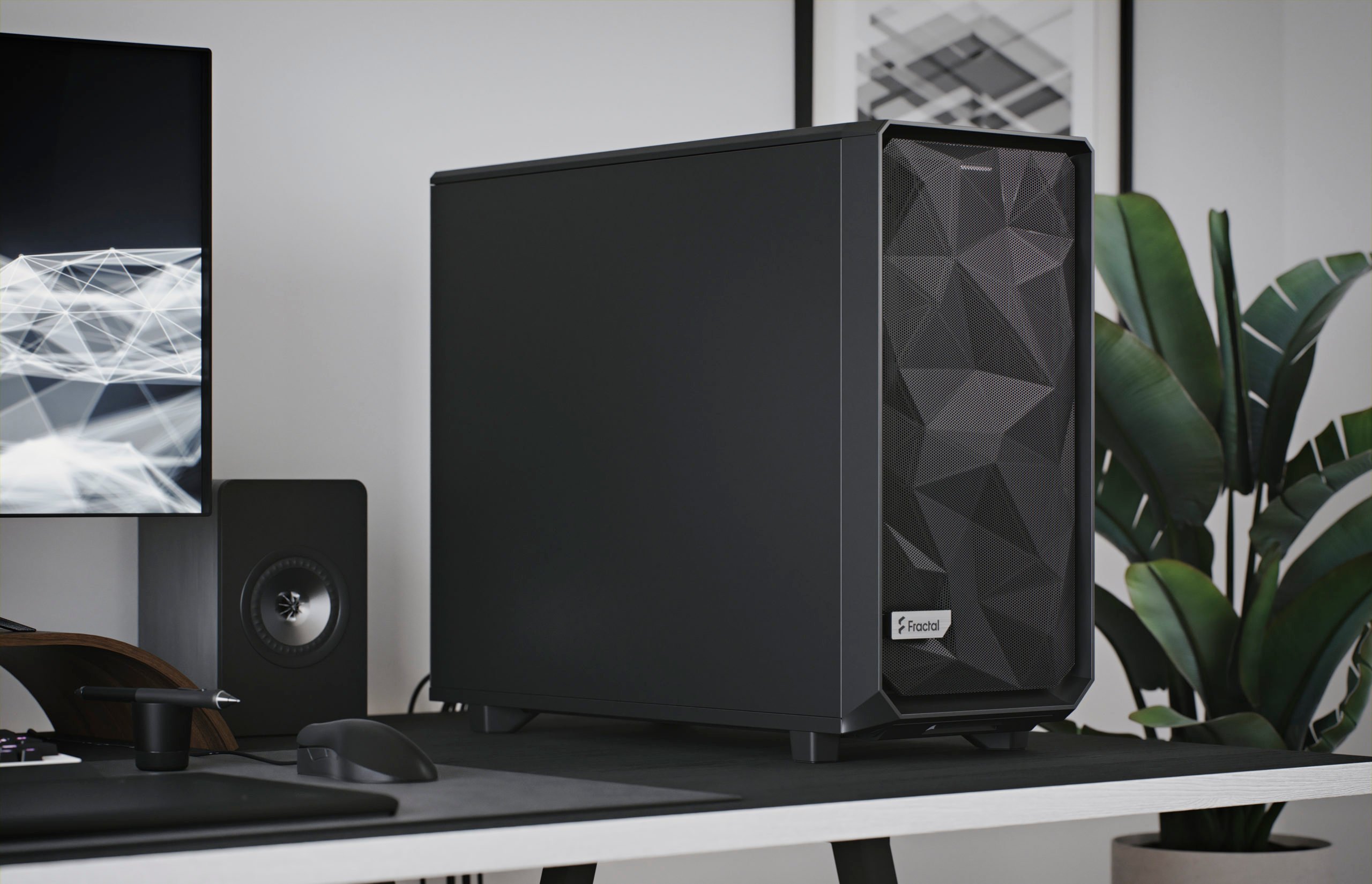

Fractal has good cases for this sort of application though. I originally used a Node 804 which has more than enough capacity for 10 drives + 2 x 2.5" in the front face. It's mATX though. The new case I used which has easily IIRC 13 mounting spots for drives near the front grill and the side panels / front snap off w/o tools to get access.
The only reason I switched to the Meshify is because of ADL MOBO's being ATX with the features I wanted and limited release of mATX options at the time of the build. Both of them get good airflow though and are subdued without all of the rainbow farts if you don't want them. There's a single indicator on the front of either for power and that's it.
The 804 has 2 hangers on the storage side for 4 drives each and they slide out for mounting.
The Meshify has a "rack" system with shelves the drives mount to and then a couple of thumb screws to secure them. I could envision using a cage system though if you wanted to use backplanes and such as it has plenty of room and some quick modifications could make it work. Easy access to the MOBO for HBA's or SAS and since it doesn't have windows no need to worry about cable management.
Phanteks also makes some good storage options as well. The couple of cases I used had room for 6-8 drives in official mounting positions but, plenty of room for more if needed.

Someone on a NAS forum also recommended the Node 804. It's nice and compact but replacing a drive looks like a pain and it's super wide. I've seen the Meshify 2 and was looking at it for its cooling properties for a gaming PC but I had no idea it has a "Storage Mode". I just watched a video on the conversion process and I'm pretty amazed. It's slightly cheaper than the Silverstone and looks nicer.

The reason I wanted a NAS is because my current case NZXT H500i can only hold 3 hard drives. It was my primary storage for all my data and video editing. I had some hard drive corruption and figured now is the time to look for a NAS or other option. That has me wondering if I can use the Meshify 2 XL and just move my current computer into that instead of building a NAS. The use Storage Spaces to set the RAID. I have a RTX 3090 which is massive and a 280mm AIO for CPU.
EDIT: The GPU might fight in Storage layout. My card is 323mm.......Here's the specs.
  • GPU max length
    Storage layout: 359 mm, Open layout: 549 mm (524 mm w/ front fan)
Combining everything is an option as well. The GPU will take away some mounting space but maybe only 2 spots worth of storage.
Part of the conversion for me required moving the cage under the rack along the front but, that will hold 2 more drives on the Meshify. I'm not sure the XL would make much difference though.
I think they reversed the XL numbers
Well you can put the RAD on the top and it should still fit in storage mode. I was debating WC vs AC while designing and went AC with good results. I do get a config alert on the GPU length with the non-XL Looks like a 5mm potential issue.
The Fractal Design Meshify 2 ATX Mid Tower Case supports video cards up to 467mm long, but video cards over 315mm may block drive bays. Since the Gigabyte GeForce RTX 3090 24 GB GAMING OC Video Card is 320mm long, some drive bays may not be usable. The Fractal Design Meshify 2 ATX Mid Tower Case hard drive bays are positioned where some of the bays may be physically blocked when using longer video cards.
Either option I mentioned would have enough airflow though for keeping everything cool and not too cluttered / restricted.
Using the Arctic PWM PST fans make things a bit easier to run the fan cables to the header similar to the STA power cable I shared before.
Thanks for looking that up. The only sad part is find this case lol. I see it on NewEgg but shipping to me is very expensive. Amazon has an XL version but its used but still cheaper since the shipping is free.
I love those Arctic PWM PST P14 fans. I use them in a couple of computers and they silent and powerful. I was thinking of putting the Rad on top like you mentioned and then load the front up with 2 or 3 fans depending if I go with 120mm or 140mm fans. I'm using an MSI Gaming X Trio 3090 which specs out to me 323mm. In my NZXT case I have 1/2" or less of space between my card and radiator.
I'm leaning towards keeping the NAS and doing a Meshify 2 case for additional storage. I'll need a place for redundant backups. If you can't tell I've lost data in the past and I refuse to let it happen again lol.

Mesh - I put 3 in the front / 2 on the top / 1 for the back // 2 120's on the AC tower which seems to be more than enough w/o taking into account your 3090 monster heater into account.
