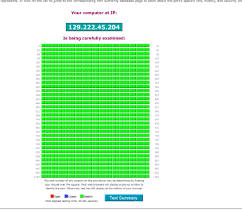

every firewall checker i have ran show no ports open or security issues with cginat and the firewall off. i guess is the few people that possibly are sharing my not public ip may be able to get some sort of access if they can figure that out.. but i doubt it as dont know how they would and even when i run it (on the same ip) nothing gets in.
i guess it would stop misconfigurations or infected devices inside the network from getting out but not too worried about that.
