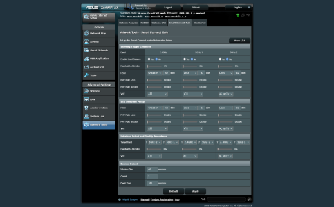

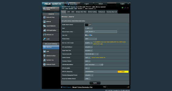

  3. I had some trouble getting my devices to connect to the 2.4Ghz SSID, despite using the same SSID and password.
    1. I had to fiddle around with the Wifi Setup screen, by changing and reverting the authentication method, re-entering the password, and rebooting multiple times. I really hope this doesn't become a recurring thing.
    2. It's hard to tell when the updated settings are actually "sticking". Clicking "Apply" at the bottom does not seem to do anything without subsequently clicking "Reboot", at the top.

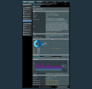

  4. The 5GHz-2 band is running way hotter than any of the other radios and the CPU. It hovers around 75F, and spikes up to over 100F
    1. Screenshot attached

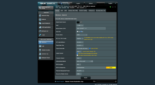

  5. The 5Ghz-2 band SSID is not visible to any devices.
    1. SSID is marked as visible in Network Info. Screenshot attached.
    2. I tested multiple devices, including a late-model iPad Pro that supports 5Ghz and 6Ghz Wifi 6E
      1. Is it possible to enable the 5Ghz-2 band, and ideally have it share the SSID with the 5Ghz-1 band? If not, it'd be good to know how to disable it. This would reduce the heat generated.

No, you cannot disable the 5Ghz-2 band and reuse its channel allocation for 5Ghz-1.

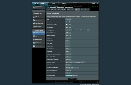

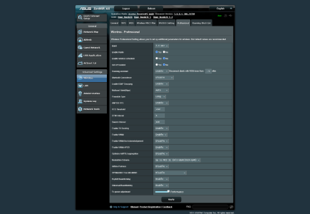

There is. The option is on the Wireless - Professional page and is called Enable Radio.

I have also attached screenshots of the Wireless --> Professional Tab. I had not made any modifications.
