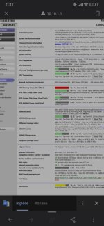

Hello guys. Did anyone found the way to fix ram issue?

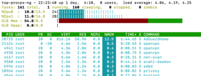

I don't really have a ram issue on my R7800 (it's 78%)
You could use top2 to see which processes use the most.
start top2
then press x so that one of the columns gets blue (so you can easily see what it is sorting on)
then use < or > to move the sorting to Mem%, VIRT or RES
I attached a sample of my router.
One thing I still don't really know for certain.
The /tmp is a tmpfs aka ram-disk -> I don't know if filling up the /tmp also increases the ram-usage.
I do know that in the past, I had issues with AGH filling up /tmp -> so I disabled query logging to stop AGH from crashing.
(I now have relocated my AGH files to USB, so I have re-enabled it).
Also I think that the amount of rules that are loaded in AGH might have an impact on memory usage. So don't enable too much lists.
(I only have Oisd enabled)

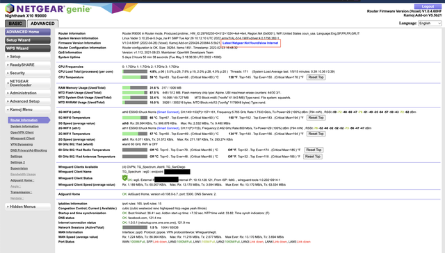

Hello Gerrits,
appreciated always your replies.
i have cleared AGH registr and RAM drop down from 94% to 76% which reflect what you are saying about /tmp
then i have not found "top2" in the menu but only "top"
how can relocate AGH registr to USB drive?
Thank You
Hello Gerrits,
Thank You
with top2 I meant running it from within a ssh (or telnet) session.
looking back at my earlier posts:
(and assuming our USB gets mounted to /mnt/optware )
stopped AGH via add-on GUI (setting DNS filter/encryption to none; had to do this a few times before it would stick)
and then from ssh / telnet do:
mkdir /mnt/optware/adguard_home/
cp -r /tmp/addons/adguard_home/* /mnt/optware/adguard_home/
rm /opt/scripts/firewall-start-adguardhome.sh
Then edit /usr/bin/addon_adguard.sh via:
nano /usr/bin/addon_adguard.sh
find the line that starts with tmpdir= and change it to
tmpdir="/mnt/optware/adguard_home"; [ ! -d "$tmpdir" ] && \mkdir -p "$tmpdir"
Then edit /www/adv_index.htm via:
nano /www/adv_index.htm
and find these lines:
var adguard_port_dns = "<% cat_file("/tmp/addons/adguard_home/port_dns") %>";
var adguard_bind_port_www = "<% cat_file("/tmp/addons/adguard_home/bind_port_www") %>";
and change them into:
var adguard_port_dns = "<% cat_file("/mnt/optware/adguard_home/port_dns") %>";
var adguard_bind_port_www = "<% cat_file("/mnt/optware/adguard_home/bind_port_www") %>";
start AGH again via add-on GUI
(hope I didn't make any copy / paste mistakes)
Also, these steps (except the mkdir and cp -r commands) would need to be repeated after each new Kamoj install.

RAM Memory Usage (Used/Total) 89.3 % 898 / 1006 MB
MTD Flash Usage (Used/Total) 87.5 % 448 / 512 MB. Flash memory chip type: Alpine. UBI max/mean erase counters: 25/14 2/1.
MTD System Disk Usage (Used/Total) 41.3 % 20.523 / 49.727 MB MTD Block:mtd5 ("rootfs" 41.943 MB) Type:nand. File system: squashfs.
MTD NVRAM Usage (Used/Total) 10.0 % 39510 / 393216 bytes. MTD Block:mtd12 ("config" 1179648 bytes) Type:nand.
So it looks like AGH simply went out of space? Shouldn't it clear some data automatically instead od just going down?
well perhaps it should, but its programmers probably assumed that would be run on a disk with sufficient space to always at least store 6 hours of logs.
Options: reduce the amount of hours of query-logs to retain (or disable if you already had it at 6 hours).
Or (as I explained a few posts up) move AGH from tmpfs to USB
I had the query logs option to store 90 days... so it has killed the router after 48 days, not bad. I changed it to 7 days now.

I'm having a weird problem with my R7800. I've lost twice in a week my 5GHz WiFi. Came home, and only the 2.4GHz was available. My only option seems to reboot the router, and the 5GHz comes back and my WiFi devices are functional again.
Kamoj said there was the possibility to restart the WiFi in Kamoj Menu / Supervision
So I've checked the Supervision boxes :
And also the Supervise WiFi radios box.
But I cannot see where I can restart the 2.4GHz or the 5GHz WiFi. I don't see any Restart box anywhere.
If someone could show me where I can find those options? A screenshot would be great :)
Oh! I'm using the latest add-on of course, and latest Voxel firmware :
Router Firmware Version (Voxel) V1.0.2.93SF
Kamoj Add-on V5.5b20
Hello everyone,
I had stated a question about Mr Kamoj's add-on on this threat : https://www.snbforums.com/threads/c...r-r9000-r8900-v-1-0-4-59hf.78320/#post-756833
but I think it's better to continue it where it belongs :)
There is nothing more to do.
From the other thread:
SUPERVISION: Supervision On
Supervise WiFi radios.
The log is in System Information, Supervision: Show.
