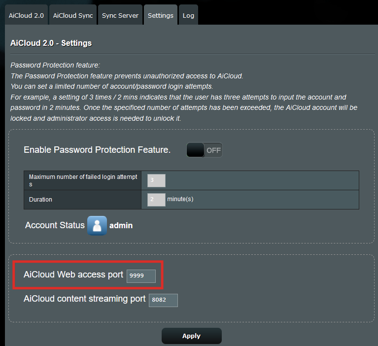

Looking for feedback: Anyone considering AiCloud important to them?
Is there an issue with WAN access if you are patched, have SSL cert with 2048 key length, and complex, long length, non-dictionary password, also the ability to lock down to certain IPs?
Yes. The web server is a custom made http daemon, and over the years there are constantly new security issues that are found, allowing to bypass authentication. Use a VPN instead.

I think the bigger problem like exposing your UI router interface to the internet is that it relies on passwords. Even with a timeout and captcha that stops brute force attempts it doesn’t utilize 2FA or MFA rolling codes or something like fail2ban which would help. Still if a vulnerability is used in something like the web server outside of password guessing those methods still may not stop intrusion. Certainly a complicated issue, which is why you shouldn’t allow WAN incoming access directly to your router.
At least with VPN servers they don't use passwords they use private keys and they are highly scrutinized and tested and not limited to ASUS devices which allows vulnerabilities to be better detected.
If you host an actual server you have the same risks. Except hopefully you have a experienced IT guy who is using a much newer kernel and is receiving frequent updates and patches. ASUS only does updates with its routers maybe 2-3 times a year and they certainly don’t update the kernel except for backports. Which is terrible. Software in routers tend to be old.

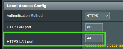

Exposing the login page of your router to the internet is never a good idea, no matter what gear you use. If you really need remote access, you should use a VPN.
Why can I securely log into my bank and many other sites, but not into my router? Can't Asus even do something this simple?
I use VPN now, but if it were not necessary, it would be easier for me and other regular users.
Because it requires constant patches and updates to the web server software, and still poses some level of risk. This makes sense for banks, as they are designed to be accessible from anywhere, but it doesn’t make much sense for a home router, which is meant to be a local device.
