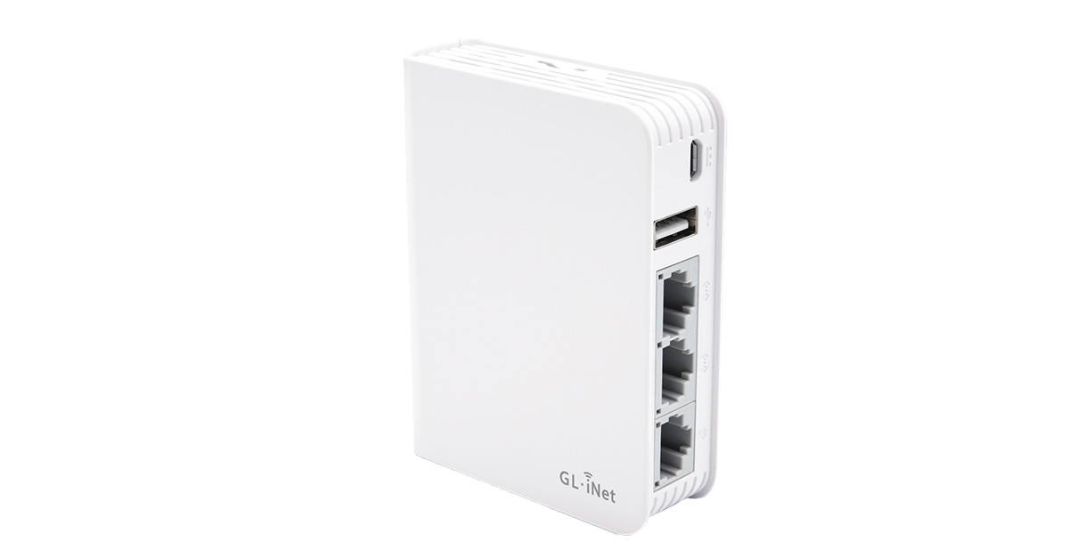

but even cheapo travel routers are two stream
If you can find this one - it has 1x AC radio:
Gigabit version:
I just realized I actually had one GL-AR750S.
