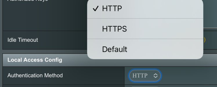

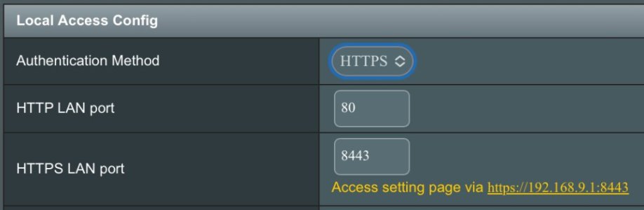

Did you happen to change Authentication method in Administration, System, Local Access Config, from http to https? If yes then the port (see example) will need to be supplied as well as https. vs http no “s”.
