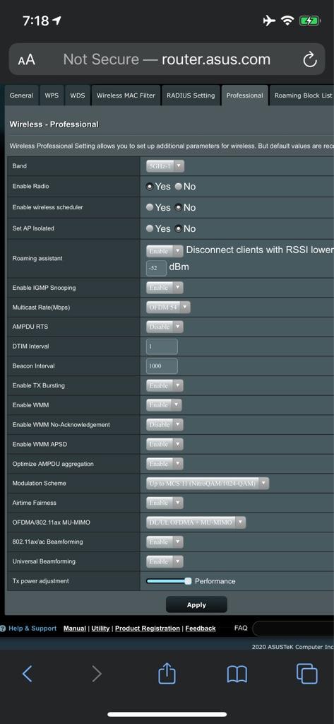

I bet it’s the settings because I can pull up a web page from 6 houses down the street from the router, no problem. I played with settings until I got the best performance.

Here’s my settings... check them out. Took me a long time to come to these settings where everything is perfectly working, including near-perfect roaming behavior
Thanks for posting your settings, I just got a XT8 and you’ve been a giant help.
