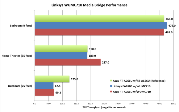

Here's a quick review of the WUMC710: http://www.techhive.com/article/2013452/review-linksys-wumc710-wireless-media-bridge.html
