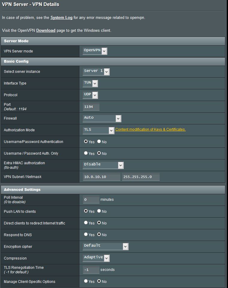

Hey guys so I flashed my AC66u this evening - all is good. But I am trying to setup OpenVPN and having some issues. Firstly - does the firmware generate the OpenVPN config file (ovpn?)
Secondly, I have this error:
OpenVPN server failed to start! Check your configuration, then try disabling and re-enabling it. (Error code: 0)
I am super tired so I might just be looking past something, but here's my settings:
Merlin OpenVPN settings by Jon Kensy, on Flickr
Saw this in logs:
Jul 22 20:28:25 openvpn[6020]: OpenVPN 2.3.4 mipsel-unknown-linux-gnu [SSL (OpenSSL)] [LZO] [EPOLL] [MH] [IPv6] built on Jun 6 2014
Jul 22 20:28:25 openvpn[6020]: library versions: OpenSSL 1.0.0m 5 Jun 2014, LZO 2.06
Jul 22 20:28:25 openvpn[6020]: PLUGIN_INIT: POST /usr/lib/openvpn-plugin-auth-pam.so '[/usr/lib/openvpn-plugin-auth-pam.so] [openvpn]' intercepted=PLUGIN_AUTH_USER_PASS_VERIFY
Jul 22 20:28:25 openvpn[6020]: Diffie-Hellman initialized with 512 bit key
Jul 22 20:28:25 openvpn[6020]: WARNING: POTENTIALLY DANGEROUS OPTION --client-cert-not-required may accept clients which do not present a certificate
Jul 22 20:28:25 openvpn[6020]: Cannot load certificate file server.crt: error:0906D06C:PEM routines:PEM_read_bio:no start line: error:140AD009:SSL routines:SSL_CTX_use_certificate_file:PEM lib
Jul 22 20:28:25 openvpn[6020]: Exiting due to fatal error
Jul 22 20:28:38 kernel: DROP <4>DROP IN=eth0 OUT=eth0 <1>SRC=93.180.5.26 DST=10.0.0.2 <1>LEN=60 TOS=0x00 PREC=0x00 TTL=235 ID=54321 PROTO=UDP <1>SPT=40608 DPT=53 LEN=40
Thanks all!
