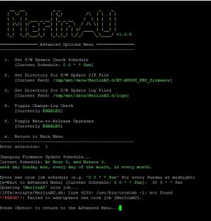

I just installed this script via amtm, then tried to change the update schedule. It failed. See the attached screenshot.
Just uninstalled and reinstalled and have no issues here.
Can you send me a photo of your settings and a copy of your logs via PM?
