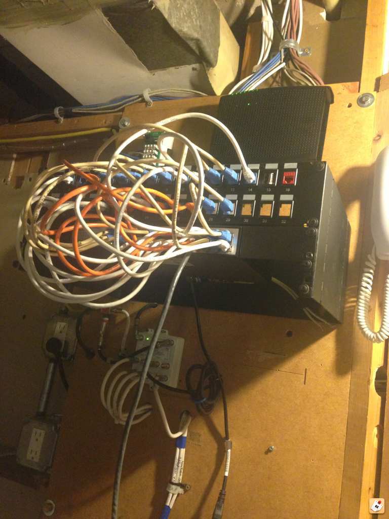

I have a weird butt house that was a 1900 with a 2005 add on, so coaxial is my only option and its already bought anyway. My wireless will not reach the addition to the house.
using : http://www.amazon.com/dp/B00B89EU1W/?tag=snbforums-20
My question is : Can 2 mocas adapters connect to the 1 main moca adapter through a splitter near the cable modem? as pictured below.
Or will I need to buy a 4th moca box to make this work? (im also assuming if both are in use it would be better to get that 4th box anyway since 10 megabytes per second can be bad) (splitter is a 2ghz)
I only tried trouble shooting for 15 minutes but I couldn't get both to work at the same time
How would you connect the fourth MoCA adapter?

The modem has multiple ethernet ports so those 2 cables after the splitter would just be in their own moca
Cant answer either questions for sure but 1 cable is 50 the other id guess at 200. I got them to work individually but need to test more if they can work at the same time

Yes two or more MoCA adapters can connect to one MoCA modem. I'm a little confused on a couple things, guessing you are typing from a phone.
- Your splitter doesn't dictate the speed, the frequency rating of any splitter using digital cable or satellite should be 0-2000Mhz if I'm not mistaken. A regular 2-way splitter will give you -3.5dB of loss on each output, then you'll also have some loss for every foot of cable (and 200ft of coax is a pretty huge run, and every termination & coupler on a run also introduces some loss (and obviously downstream splitters as well would introduce more loss)
- check out the config manual for your adapters here for more setup info (try resetting, then do the far one, then the shorter one) ftp://downloads.netgear.com/files/MCA1001_UM_19Dec08.pdf
- those MoCA adapters are about 5yrs old, 1st gen MoCA. In my personal experience I've achieved steady 15-25Mb/s on similar vintage ActionTec MoCAs of runs in the 50-75ft range, I also used a power amp to distribute my coax and it was a star topology with no downstream taps over single shield plain RG-6 (which you probably have).
- personally I never noticed slower output when 2+ of my adapters were being used
- I'm unclear on "those 2 cables after the splitter would just be in their own mova"
- if you're having problems with the far unit you could try swapping out your splitter with a tap, and shunt the 7db of loss all to the short run, you could also try an amp (or amplified splitter) they aren't that expensive.
- In my own test & use I've found MoCA to be pretty underwhelming and I get far greater speeds using cheapish 802.11n APs running DD-WRT as bridges, and pretty acceptable distances over 2.4ghz and even over 5ghz depending on environment and equipment.
Each moca would have its own ethernet port, then connect to each of its own coaxial. Trying to save the 50 bucks is why im asking

The splitters need to be over 1.5ghz since moca operates there
No amplifier currently helps that frequency and blocks moca unless its amped before the moca bridge
Your through put seems bull since 180 megabits is the max roughly 22mbs?

- wifi goes through doors ;)
- MoCA v1 & v1.1 operate below 1.5ghz, I'm pretty sure your adapters aren't v2, but regardless I was stating that the freq range of your splitter wasnt the issue.
- I implied look at config file to follow reset and clean setup procedures
- my throughoutput is bull since my off the top of head estimate was -7 to +3 MB/s or whatever over MoCA v1.1 advertised claims??
- MoCA 1.1 standard supports 16 adapters
- MoCA v1.1 uses 500-1.5ghz, my amp covers the lower half of that range (regardless, MoCA v2 uses to to 1.65ghz, I don't think and amp will hobble it)
- amps don't block MoCA, I was sharing my personal experience of mine working vs your experience of it not working, of not getting your stuff to work, so trust me, I would be the first person to tell you if it didn't work.
Regardless, try a tap instead, they're like $8. Other than that, saving $50 by using 5yr old tech and wanting it to work fast and easily today might conflict. Hence why I sold all my MoCA stuff on eBay last year.
Directly to the right of the coax amp/distributor is the spot previously occupied by a MoCA adapter. :)

Is that the difference between the mca1001 & the mca1001v2? It's not a product I'm super familiar with and didn't catch it you differentiated earlier. I just know the regular mca1001 was released pre MoCA v2 standards.
Anyway, look forward to hearing your results, and I can personally attest that splitters & amps don't block MoCA adapters.

With the problem that you're having with getting both connections running on the same MoCA network with the splitter, I'd just spend the extra $50 and have each leg have its own connection back to the router. This way, if one network fails, you can simply diagnose it on its own versus having to redo all this. Better to spend $50 and have it working solid and not mess with again because something marginally working broke.

Yea its not possible to connect it had i had done, it wont communicate simultaneously. So unless youre ok with unplugging one or you rarely use one of them youll need 4
