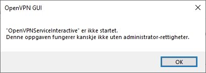

It used to be "piece of cake" (easy) to install a new client1.ovpn file, but this time I had several problems. On my android mobil it demanded a newer ovenovp - which worked OK, but on my computer the same solution failed. I have checked the new client1 file against the old and there is some small differences: The two lines about chipers!
I enclose these (client0 is the old) and also the popup with red warnings and the client1.log and a small popup about "not started" when i start Openvpn Gui (which seems to start anyway).

I can't understand that language, but it seems like a permission issue. Uninstall then reinstall OpenVPN on your PC, making sure to also install the services as well (otherwise, you would need to run OpenVPN GUI as an administrator).

Thanks, now I have uninstalled and reinstalled openvpn on my computer. Managed to establish openvpn contact and able to watch my webcamera remote, but the client1.log show som problems with "cipher" and "BF-CBC" (I don't know what this is). Here is the first lines of the log:
