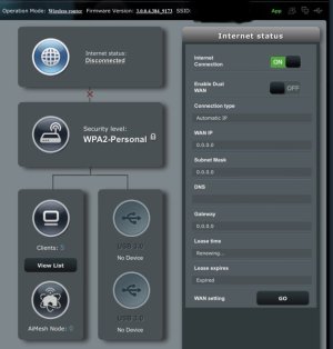

I've attached a screenshot of my ASUS GUI. The AX86u is not picking up WAN IP address, no DNS, no gateway, can't seem to renew the lease.
I tried to manually update the firmware downloaded from Asus.com and I failed to do that.
It does not give me any error message it reboots automatically when the update is completed, but when I log into the router it stays in the old firmware.
It has been more than 5 days and it's really driving me crazy at this point. 😖 I don't know if this makes sense but I think my router bricked. Despite all the LED lights still working well (white and red), my router has no connectivity whatsoever.

Welcome to the forums @NotDW.
It's not possible to have an RT-AX86U and have RMerlin firmware 3.0.0.4.384_9173 on it.

Thank you @L&LD you saved my life
I think this is why my router was acting weird. In case someone run into my issue again, I will post the solution here:
I went on Asus.com and downloaded their firmware restoration tool, connected my router to the laptop, force installed the latest firmware, now it’s back to alive.
Not sure why I ended up with the wrong firmware but glad I had everything sorted out now.
Thank you for your help!
You just never updated the firmware on this router.
3.0.0.4.384_9173 is perhaps the initial firmware around May 2020.
