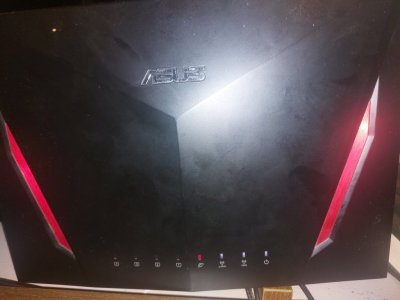

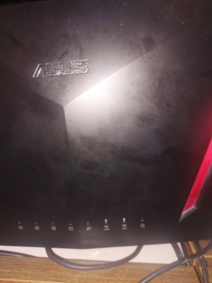

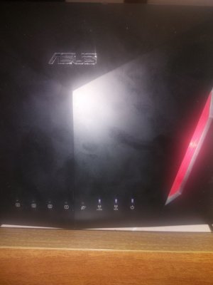

I don't know but, the router is acting weird if I exit rescue mode by turning off the router using the switch it won't work and only power led will light up but, if I turned off the router for few minutes all the lights and the router will work normally but once I connect to the router it will go crazy again and get stuck lights and lights go off and these strange stuff.
so, I think it's firmware issue if I managed to fully flash and restore the firmware correctly, I guess it will work normally again.

I have no clue but, what I meant by the LEDs acting weird they act weird is when put the router in normal mode and connect it to an Ethernet but, in rescue mode or after hard resetting the router they will light up normal, but all weird stuff happens when I try to connect to the router.

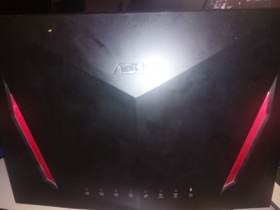

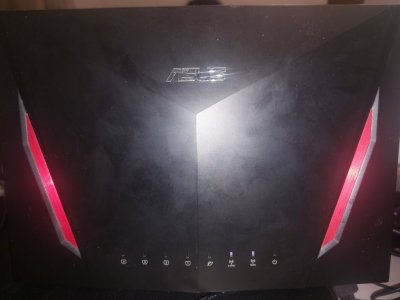

Your photos are showing an AC86 not an AX model as the front is different on them.
It was asked earlier up discussion if they had the RT-AC86U or the RT-AX86U, this was the OP's reply:
I have the RT86U the old version of the AX.

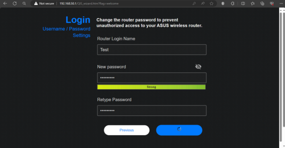

What I have done lately is I let the router few minutes and connected to the router via WIFI and managed to enter setup process but, during setting up the router the router software break as usual that's what makes me sure this is firmware issue as restoration process can't completed successfully.
and of course the red internet LED turn off and the router become inaccessible or unusable again I have to turn it off for few minutes to reset it to be able attempt once again.
