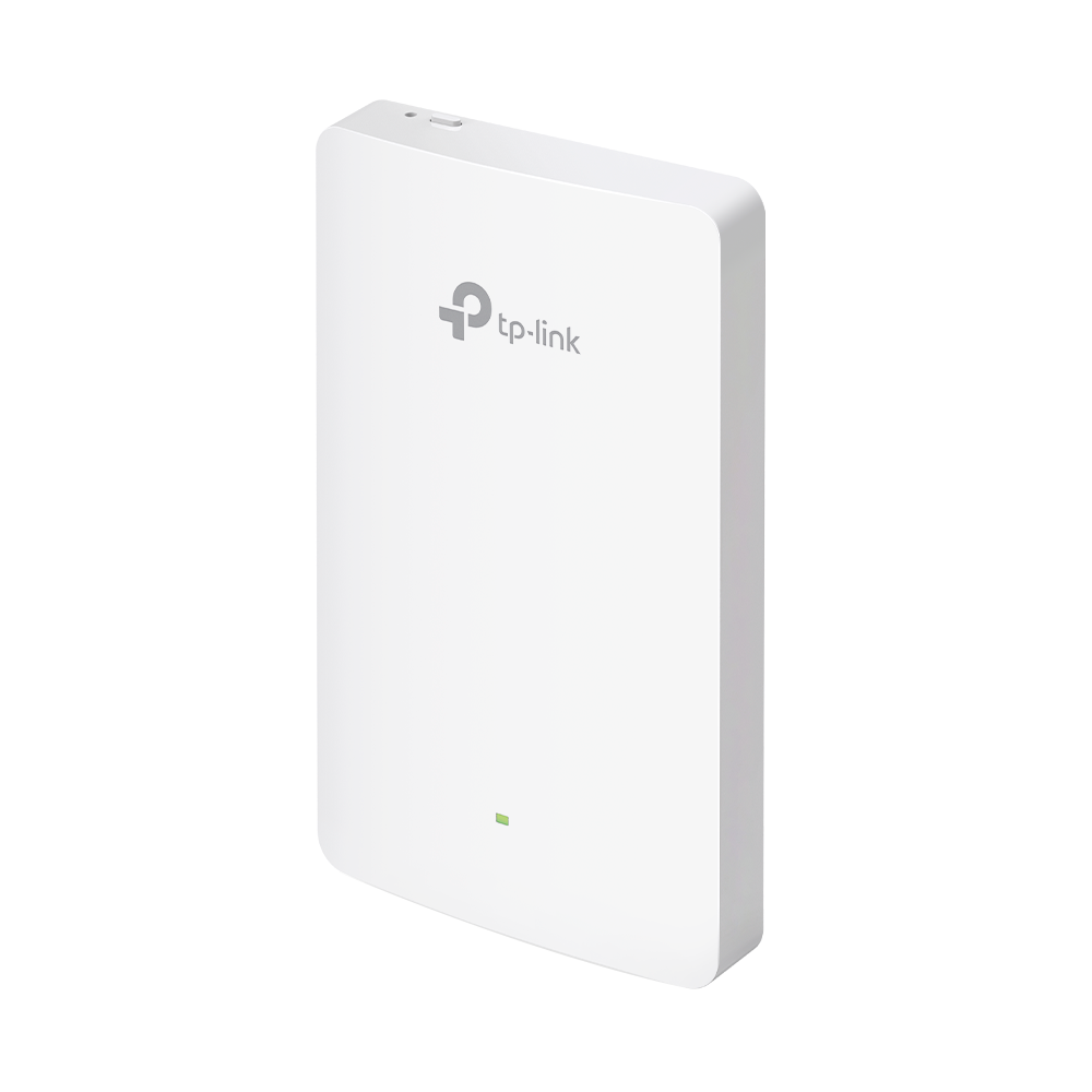

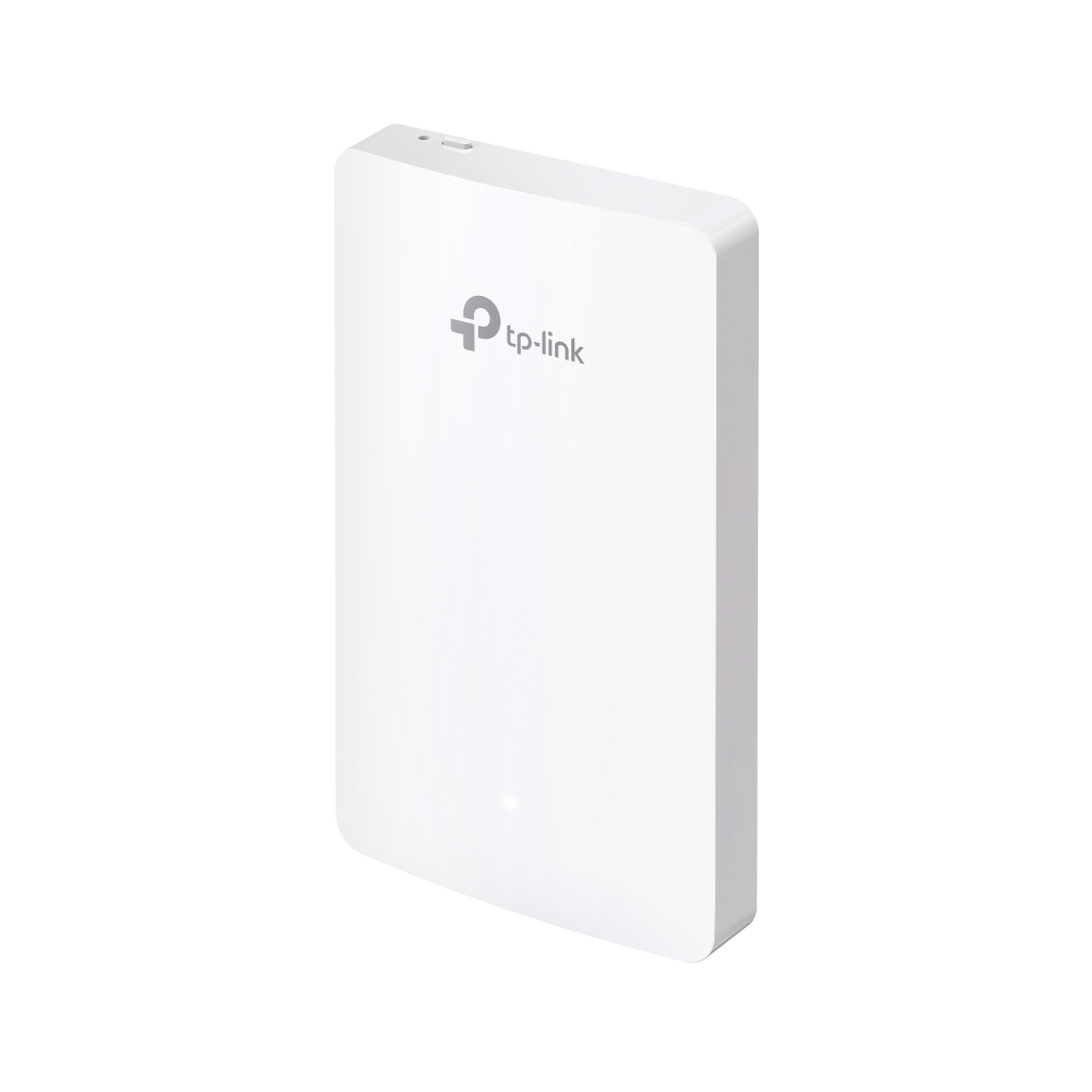

In a difficult Wi-Fi environment you need multiple 2x2 units. Paying extra for 4x4 won't give you any performance or user experience advantages. The equipment choice is somewhat limited in your country, but I would even go with wall plate APs on low power. One per room on 20mW for example.
This style is getting popular lately.
It's nice, as I don't owner of this house, I don't want to start make any drill on the walls, prefer to put it on cabinet for example.
